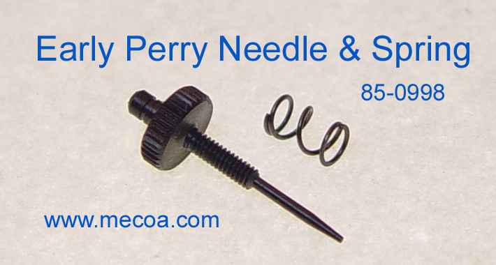

This style needle?
Probably our part number 85-0502 or 85-0202 will work as it is for the smaller carb.

it wasn't actually the needle like i thought .. its the piece the needle screws into inside the carb body ... i can't remember what it is called . i have a picture i just can't figure out how to load it. it broke in to two pieces so now my needle has nowhere to screw to.. truth is the carb i have ...the needle must be an older version it doesn't seem to have a spring ?

Postby MECOA » Fri Feb 04, 2011 11:31 am
