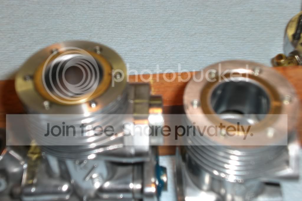

Postby USMC » Wed Jan 07, 2009 6:23 pm
"there was a shim in place on the threaded spacer"
my bad I should have said "Head button" plus a copper shim.
here are some pic's which show the raised sleeve and is not flushed.
Itryed to tap it down and it will not go down.
the pic on the right is a other crank case & sleeve that fits just right.

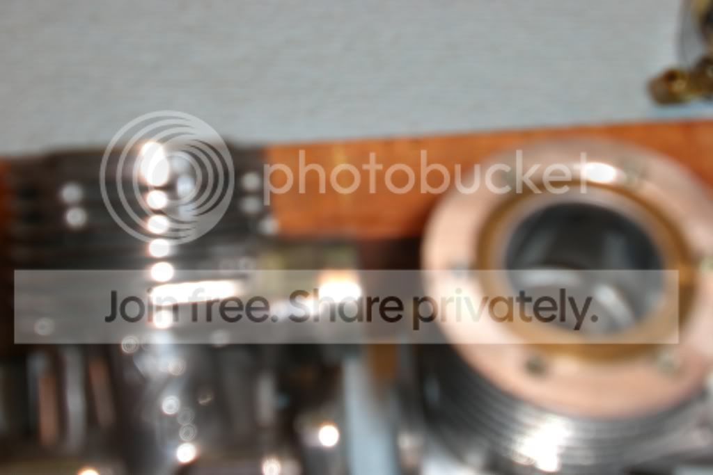

Postby USMC » Wed Jan 07, 2009 6:45 pm

Postby SteveM » Wed Jan 07, 2009 8:14 pm
I believe the sleeve has a lip on the outside that coincides with a relief machined in the crankcase which is the way it was designed at one point in time. The head button fits into the sleeve and the brass head gasket frms the seal. The fact that the cylinder head doesn't come into direct contact with the crank case and that you can see the head bolts isn't a problem.

Postby USMC » Wed Jan 07, 2009 8:52 pm
Thanks Steve
I just never seen one like this before.
I also could not remove the sleeve its in there real good.
I know about baking it in the oven to remove the sleeve.
