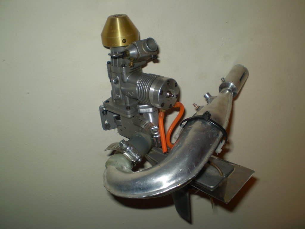

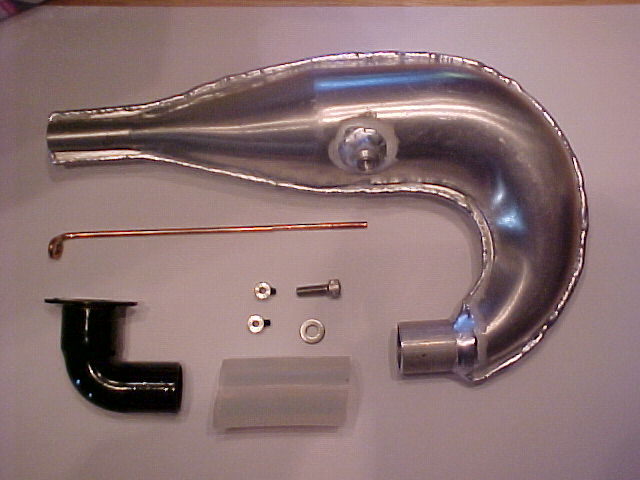

There were three tuned exhaust systems that I remember for the K&B 7.5cc outboard and the installation was a do-it-yourself project. There was the Equi, Irwin and Magic Muffler. The first two were a wrap-around type while the last just stuck straight out the back.
Irwin pipe
Irwin Pipe.jpg (43.31 KiB) Viewed 15105 times

The install looks like this.
